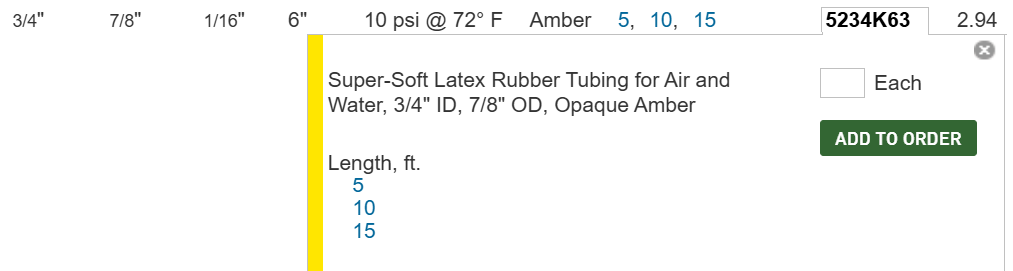

I seem to have used the last piece of the 3/4" ID latex tubing that came with my pen assembly/disassembly system. I purchased it years ago, and the small length of latex tubing they included has certainly lasted a while (over four years), but the last piece is drying out and looking pretty worn.
I've been trying to find some locally, however it seems all anyone carries anymore is a 1/4" ID or thereabouts, small, too small for use with pens for disassembly. I looked online, and the largest I seem to generally find at places like Amazon (where I could generally have it delivered tomorrow or the next day, which I need if I can get it that fast) max out at about 1/2" ID. I think I saw a 5/9ths ID, which is just slightly over half an inch. That seems like a pretty tight fit for some of the pens I work on, and I'd like to get the 3/4" ID tubing if its at all possible.
Just wondering if anyone knows where to buy 3/4" ID latex tubing (the yellowish-orange stuff)...where I could order a length of say, just a foot, or two, or three? I have found a couple places that sell it in big bulk, but, a 6" (not even, 5"?) long piece lasted me for years, so, a foot or the 3.3 feet that is often sold on Amazon, would last me till the our sun baloons into a red giant, I think..... A 50 foot roll...would certainly last until the heat death of the universe.
Oh, I guess another factor is wall thickness. I did find a couple places that sell 3/4" but the wall thickness is 1/8" which is thick. The stuff that came with the assembly station was 1/6" thick, which I haven't been able to find anywhere.
Thank you. That's what I am looking for. Seems you can't buy this stuff outside of bulk orders which are $50 or more, and won't be here till mid month next month... Largest 3' lengths I have been able to find are 1/2" or in one case 5/9" IDs.
I actually even checked the PSI site...they themselves don't even carry replacement tubing. Glad EB is here to save the day! :D

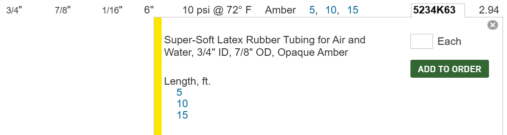

Although I advocate to support members whenever possible. There are other sources should the members not have it in stock. McMaster-Carr per foot $2.94
Hmm, I browsed around their site, and they did show tubing, but none of it was latex. I also checked grainger, and they were selling 5 feet of 3/4"IDx1/8"W for $73.90!! I figured McMaster Carr, if they had any, might be about the same price. I don't know why Grainger has it for such an exorbitant price, but...
