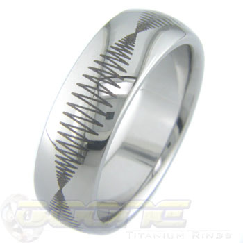

On my clip on my puzzle pen, I did use my tabletop mill with a small cutter. The puzzle pieces are engraved with a laser, and it's welded onto the body of the pen by a laser welder. One thing that's possible with around a 50 watt CO2 laser is to use Cermark, which is black ceramic that gets fired by a laser. Here's a picture of what's possible with that stuff.
Resolution is around .007" or so.
