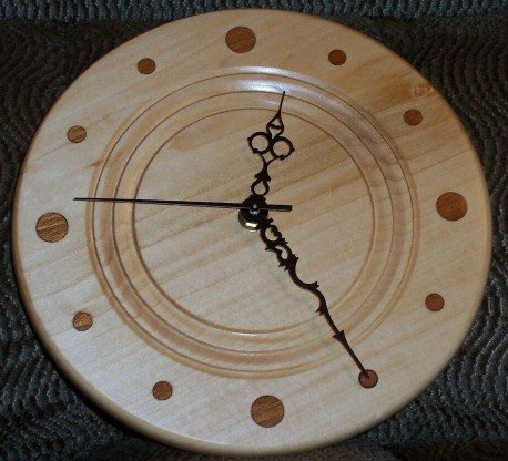

Largest I've done on my mini was a 9 1/2" diameter clock. Was turned on my pen mandrel before I had any chucks.

I jammed a slimline bushing inside the hole for the shaft. I turned 5 other clocks using this method. Haven't turned a single clock since I got a chuck.
