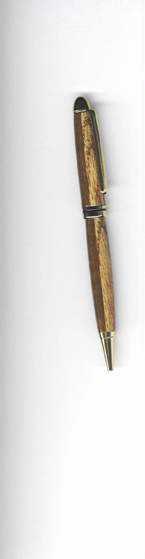

Well, the picture is terrible since my camera is not working right, but here is my first attempt at laminating. The finish is lacquer (picture did nothing to capture it) and the wood is Teak and Mahogany. Learned a bunch on this one. Hope the next few turn out better [V]
<br />
Great looking pen, Fleabit!! Looks like you did a good job on the laminating. You also might try rotating the barrel 180 degrees to get a different look to your pen. Here is an example of what I mean. Kirk[8D]http://www.penturners.org/forum/photo_album_view.asp?cname=Main+Album&mid=631&cid=665&page=9# Check out the birdseye maple/honduran rosewood example.
