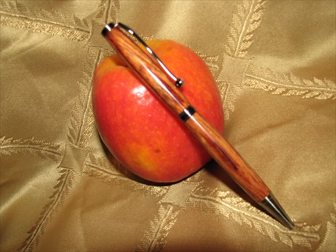

first attemp at lacquer
well here it is, macro photography will be a learned art too :):):)

Looking at this picture, I definitely see the difference the week has made. It's glossier.
Also to note is that I sanded the wood to 12000 MM before any finish was applied.
