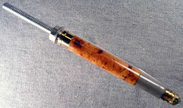

I've been questioned about my technique for dipping barrels in lacquer. First, this is not my technique. I got it from Russ Fairfield's pages referenced on our homepage. In short, I bought a few 3' lengths of 1/4" allthread and cut them to desired lengths... depending on the pens I turn. Make sure to add a few inches for insurance. When I first started this I also bought a number of different 1/4" fixtures: threaded inserts, nylon bushings, etc. to try and get a variety of widths to match the OD of the barrels being dipped. These are to be used as bushings/spacers above and below the barrels to allow the lacquer to flow smoothly down the assembly while it's drying. I now use pieces of Delrin (and other materials) turned step-wise to match the ID and OD of the barrels (this works better for keeping the lacquer out of the tubes on larger pens). Below is an Afzelia Burl Sierra barrel w/the first coat.
<br />

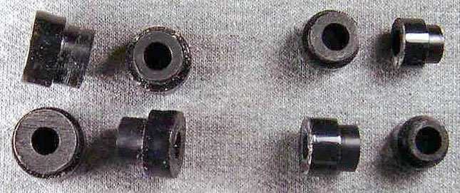

The "gold" looking part is a threaded insert, and yes it's covered with lacquer that drained into the hole that it was standing in. I snug the nut down for either side. I use anything from long hexagonal threaded collars to nuts (usually just what I have available). This one just happened to be a nut. I've also turned dipping bushings/spacers using Delrin and even a short piece of 7mm tube glued into a variety of scrap.
<br />
Make sure the transition from the barrels to the spacers is as flush as possible. Otherwise you'll get a lip or bulge of lacquer at the bottom of each barrel. You can see such a bulge at the outside edge of the Delrin bushings shown above. The Delrin bushings have 1/4" holes drilled through them so I can mount them on the mandrel to turn them. Then I put them in the barrels and run the allthread through them. NOTE: If I'm using bushings other than those I've turned with a step and I'm not satisfied with the fit at the ends, I'll seal the tubes w/base plate wax.
