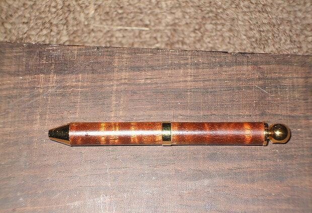

a Very nice little pen with some great wood. I think you did a fine job on this pen, only your 10th?!?![]
I will offer that you look at the hardware fit and see how you can get a cleaner fit, the wood looks narrower than the hardware. Sometimes the bushings are not matched to your hardware properly, I use calipers to gauge my hardware to my busings to make sure...that is just my thoughts to try to help your next one even better![]
Again, great work and I look forward to seeing your next pens..
