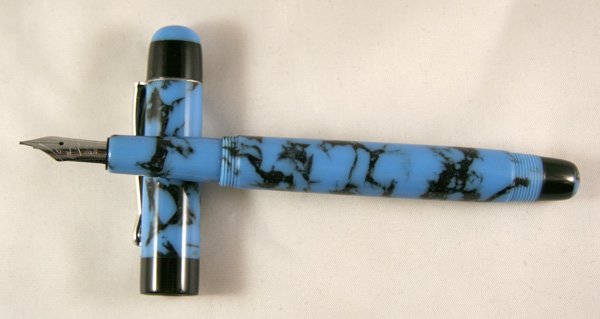

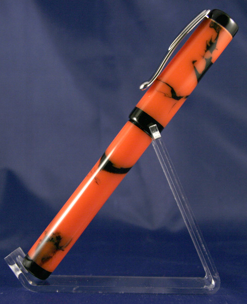

I'm two pens into my kitless journey, so this is pretty simple stuff. My two pens were made with the same set of tools. I'm not claiming these are the world's greatest pens, but they write, and they were fun:biggrin: I have the orange one in my hand, and it's about 13.5cm capped and should be about .5cm shorter if it weren't my first:redface:. The cap is about 14mm and the barrel is about 12mm. I don't have the blue one, but it's roughly the same - a little smaller:
