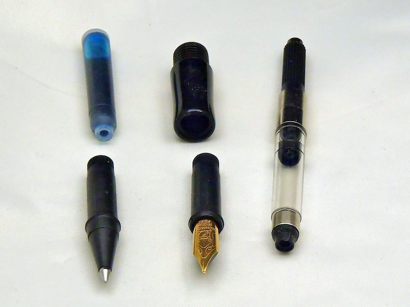

It is possible to do both with the Schmidt #5 nib and feed along with the Schmidt rollerball tip you go either way and have the benefit of the variety of fountain pen ink colours not readily available in refills. They are interchangeable with the section you make. There are at least a couple vendors that are members here that carry them.

Thanks Pete, I have both which I got from vendors on the site. Havent gotten around to using them though.
Was thinking more along the lines of conventional rollerball though.

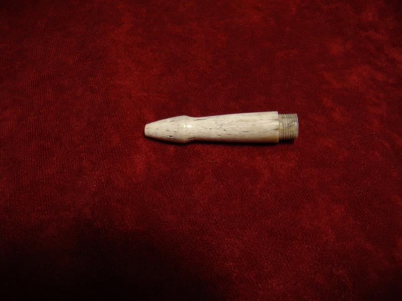

I made one kitless RB out of aluminum and also made an FP section for it so I can use it either way. Right now I am working on an antler kitless RB, I already have the nose cone built but need to get some more antler for the rest of the pen. I've screwed the nose cone onto my aluminum pen and it feels great!
