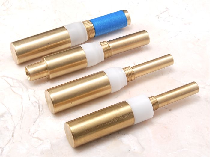

I have a metal lathe in addition to my wood ones, so I make all of my custom mandrels to suit what I am making.
You can see them here.
Lin.
You can turn both aluminum and brass on a wood lathe. I made some up a while back and when I did get a metal lathe, I ended up makng up some more. Here is a pic from the IAP site. I think Justin made these, liked his style so much that I ended up "borrowing" it for some of mine. Turn the working side to ID of drill hole with a step forthe thread you ar using, then step up to the final D of the pen. I ended up using some old brass bolts for mine.
