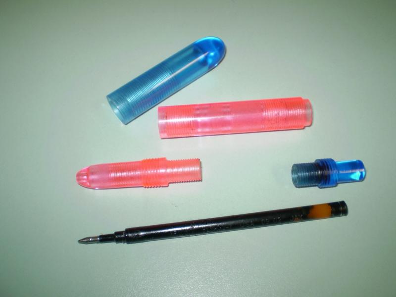

I posted this as a way of showing an excersise in threading a kitless style pen. The threads are 1/2x20 for the cap section and M10x1 for the nib and postable finial. I have been playing around wit this for a while, but couldn't figure out how to attach to a PM so here it is. It takes a G2 refill. Chuck let me know if you have any questions.

I built a similar fountain pen out of clear rod. How did you get the bore and the threads to clean up so well? My clear rod is white wherever I machined it. Said another way, how to polish inside bores and threads?

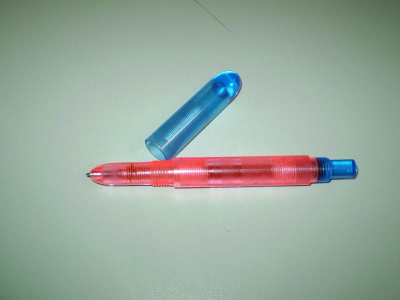

Here is another picture of the pen. Tom, I used a bunch of lubricant (Pam) when drilling. If you ever see it close up, the drill got too hot and really messed up the hole in a few spots. The material is a plexi, and I really didn't polish it any. You could no problem. Mike, I am in for a collaboration of those who want to share ideas or tips that work. I have just followed formats and how to's from other IAP members.

Thanks for posting the pics. I am at a loss for threading. I guess I need to learn.
When do you start work on that basic tutorial? :)
John,
I'll tell you the truth of the matter. Look for georges tutorial (Texatdurango)
on "Another way of making a Pen" It spells it out very plainly. The real kicker is figuring out the tolerances when you have an outer thread and an inner thread. It really helps to draw things out.
