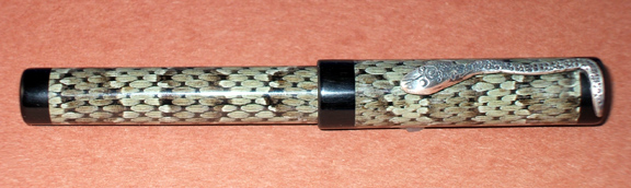

The kitless world of penmaking allows just about any dimensions, large or small. All you need is creativity. I try to let the design dictate the length and find or make the rest of the parts to fit.
Here's one a did a while ago...

I believe the pen Bruce posted utilized tubes. For the casting of the snake skins. I also believe Bruce makes some poems that are tubeless. I've made a few that didn't have tubes. A lot of whether or not you need tubes depends on the design of the pen. When your starting to do kit less work there are no rules. Experiment and see what works best for you.
So, quick question, you still use pen tubes, correct?
Actually no brass tubes in this one, though they could be used. I have never found ones that are the right diameter and thickness to suit my tastes. I made a long tenon on either black PR or ebonite (I've used both), glued the skin to the tenon, cast clear pr, turned, then made an insert on the other end. The black background works well with the skin.
The tubes at this point become optional. Strength of material you will be using may play a part in it. You can always turn the hole larger and epoxy in any parts you want to use from a kit, they dont have to be pressed in.
