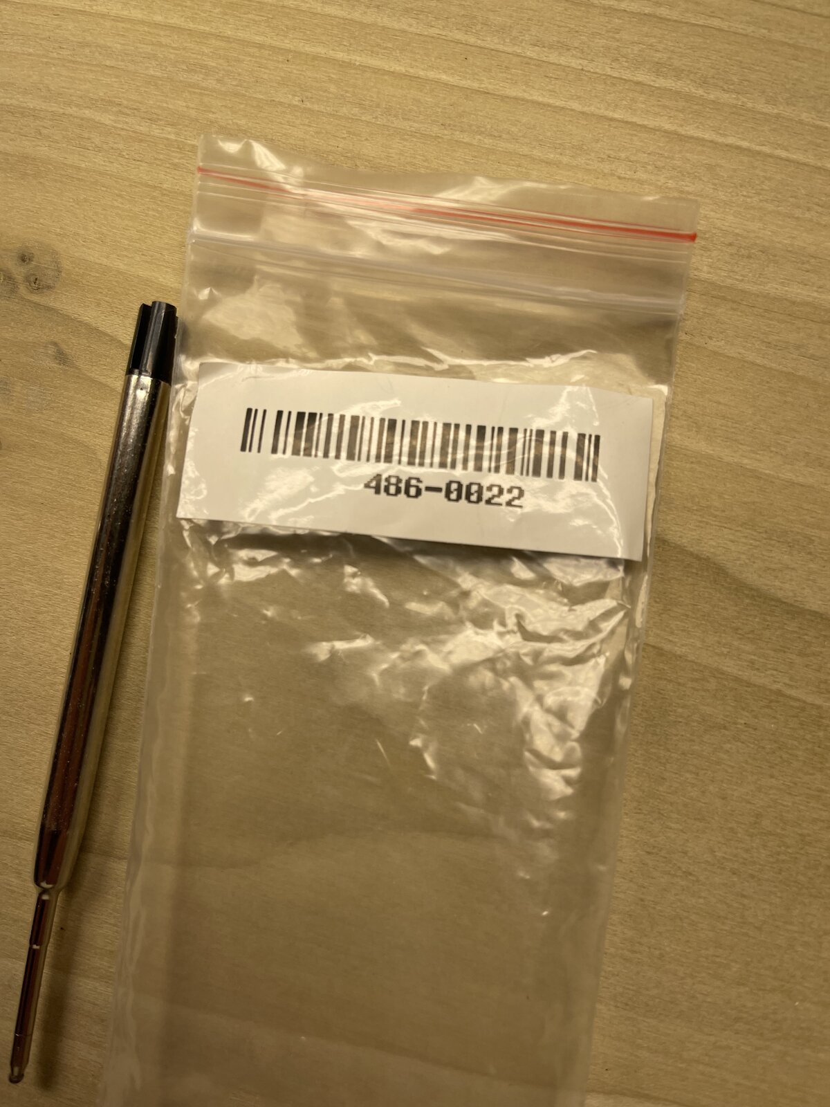

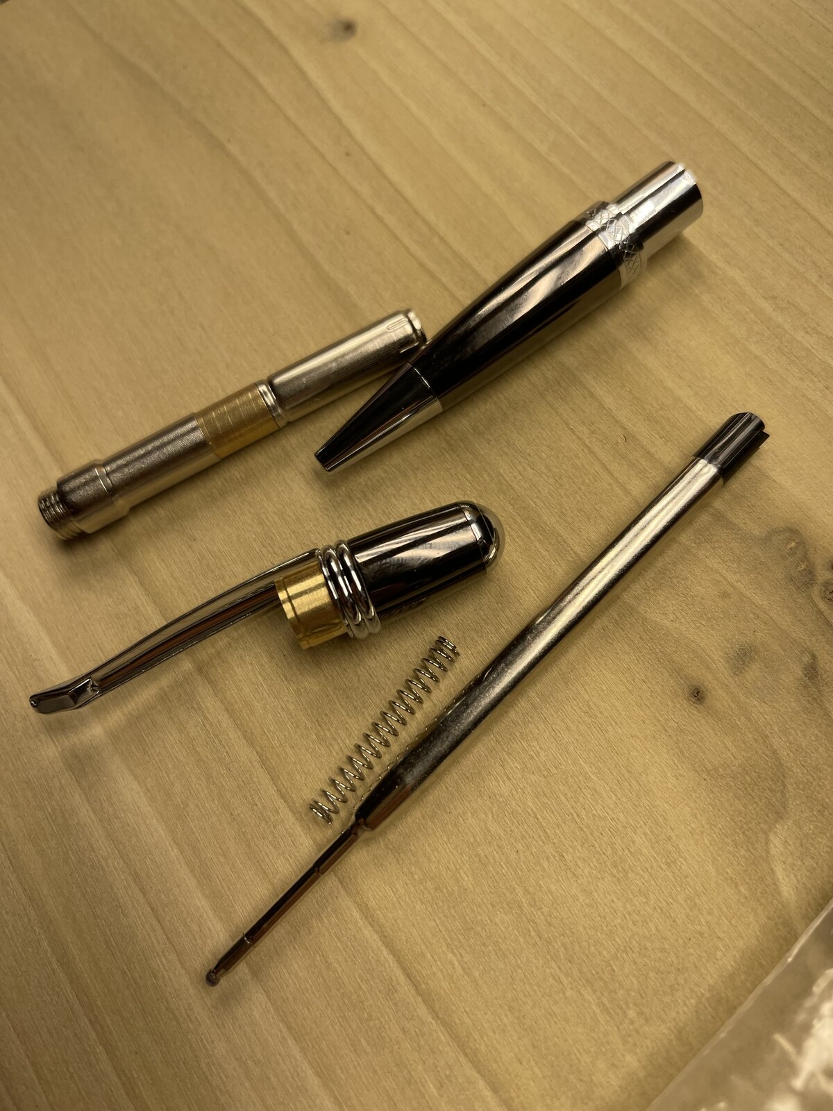

Anyone recognize this bag? I believe it is a Sierra style kit. I do not have a tube for it and am struggling to find the right diameter and length.
The cap is 10mm
Thanks for any help!!
Jim
This is probably the kit given the sku number: 486-0022
Jay
I thought that as well. I normally have a bunch or sierras. I'm out at the moment. Can someone size the I.D. and O.D. of a 27/64 tube for me?
The cap size of this kit is 25/64.
Thanks All!!
27/64" brass tube : actual measured diameters as measured by me just moments ago on a fresh, unused brass tube
O.D. = 0.411" (10.45 mm)
I.D. = 0.392" (9.95 mm) - Note that 25/64" actual for cap size is 0.391" actual
I used professional quality vernier calipers that I have found to be reliable.
I did check the zero reading first.
But bear in mind that all measurements are subject to a small +/-, which in this case I estimate to be +/- 0.0005"
