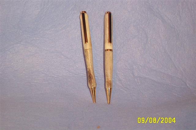

Here's an example of what I am talking about.
Both of these pens are antler,similar design style and shape.
Both are slimline kits.
When I turned the one on the right I also turned a brass ring for it.
Though the deminsions are close the ring is not interchangeable from one pen to another.
I was on a sales call talking to a jewler and we got on the sublect of plating.HE asked if the one with the ring was gold and I said no its' brass. He asked if I'd like it plated.Isaid yes and he took me to his work room and in a few minutes I had the "brass ring"
When I asked how much it cost he said a $.50 and also offered that if I had any other parts to plate he would plate them and we could take it out in trade.(By the way he placed a $300.00 order.)
In essence I took a PSI slimline kit modfied the design and came up with what I think is a unique good looking design.
