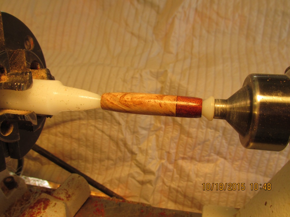

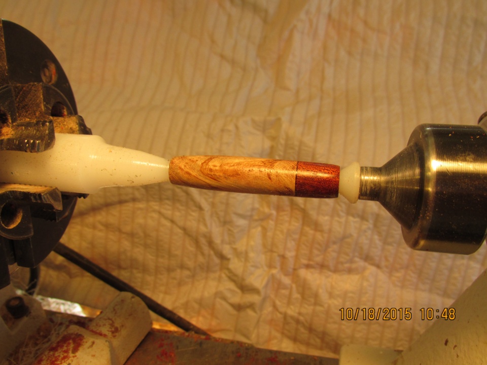

I think I might have perfected the technique for TBC finishing.
A simple taper in the chuck. A Christmas tree taper (7mm tight fit shaft) for the mandrel saver, all HDPE. I can't get it any more simple than this. :smile:
Tom, that works!
I was also thinking if that is 1/2" Delrin rod, it would fit nicely in a collet chuck.
A larger diameter rod would allow a MT2 to be cut on the back end and not need any chuck.

:redface:So I'm wasting my time with the HDPE centers and go back to the brass taper and 60* center, huh? And I was so hoping to find a use for the mandrel saver besides a paperweight.:wink:
You have a great KISS solution to a common problem, Tom. Good for you !! I have been doing something similar for quite a while but yours is an even better idea.
