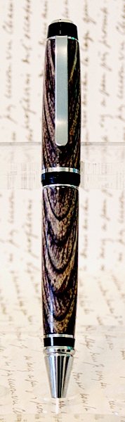

I got this blank from Bill Jacob (Ilikewood) and finally decided to do something with it... seemed a chrome cigar would be right so here it is... interesting gray laminate, I think it is like dymonwood, but does not feel the same... came out nice though... finish is sand to 600, burnish with brown paper bag, cellulose sanding sealer buffed with 0000 steel wool cloth, then 3 coats thick CA buffed between coats and EEE polish, plastic polish and Ren wax....

Looks nice! Hey how do you decide where to put the clip? I have been putting the nicest grain to the sides but maybe that is the wrong way about it.... I guess best grain on the side of the clip unless the clip covers something you want to show off?

I actually pulled that blank from a trash bin (real dumpster diving!) It is a charcoal birch laminate cutoff from production of compound bows. I guess they had no use for the last 3/4" from the sheets...luckily for us! [8D]

Great pen Tom! Looks like the same stuff I bought off eBay. One of the Patriots I turned this past weekend was out of it. I've got 11 more to do something with. Liked the way it turned tho!

Jeff as far as where the clip goes... it depends on the wood.. some woods I put the pretty side front.. some I try to hide a little defect or grain difference with the clip.. this one I decided the clip should follow the cut of the lamination.. the lamination runs bottom to top on the other side and just did not look right... all a matter of taste or what you want to hide.. LOL..

Bill, go get more of that stuff... it is a bit tricky, it's been a while since I looked at a compound bow (I shoot longbow and recurves), but they also make them in a camo pattern from the same laminations...

With my limited experience, I too use the clip to cover a bad spot or put it on so it doesn't hide the figure.

Very nice Tom, is that kind of silvery? I got one from Bill to. I cut mine last night
as well. I am waiting for the finish to dry. No wonder we both ended up with it, he got the darn thing out of the dumpster! I thought it was dymondwood I had not seen. Mine had a little
ketchup on it, now I know why.
