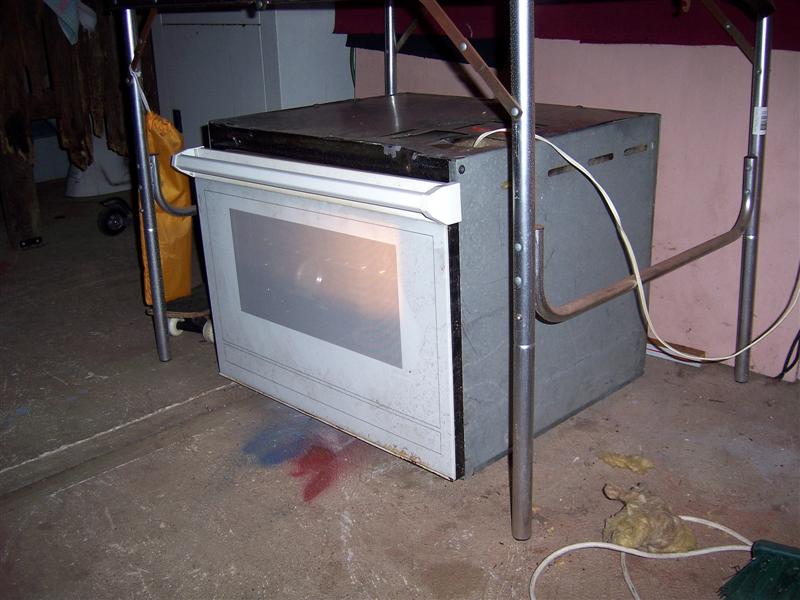

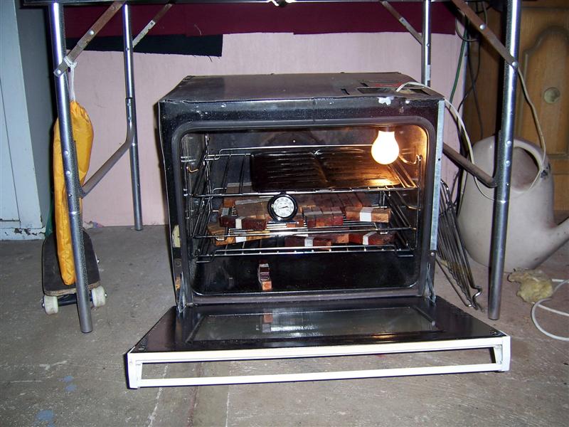

My wifes old stove nearly ended up in a scrap yard.lucky l had a brain fart and saved it, first l cut the griller part off, then l wrapped it back up using the old tin which came off the stove l then placed a 60w globe in the top and that's it Bobs your uncle, these pictures should help.
