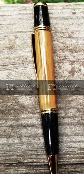

Steve, I did a Mesa pen in Ancient Amber, with a Q-tip I painted the inside of the drilled blank, let it dry, then painted the outside of the tube. I used an acrylic paint from Jo-Ann's. It is in one of those 2fl oz bottles. "FolkArt, #658 Metallic Antique Gold" The CA on the tube did not desolve and it stuck very good on inserting to the blank. I finished off with a Plast-Z , or One Step and the pen looks nice. Hope to put in on post soon. Frank
I have to agree with the op. I've done 1 of these, and even used a colored dowel. The problem is that the blank, while drilled and polished, wasn't turned down to it's final diameter. It turned out fine, but it would have been better if I'd used some yellow in the reverse paint. I gave it to my sister as a gift. She really liked it, and asked "What kind of wood is that?"
And just to prove that it really happened.:wink:
