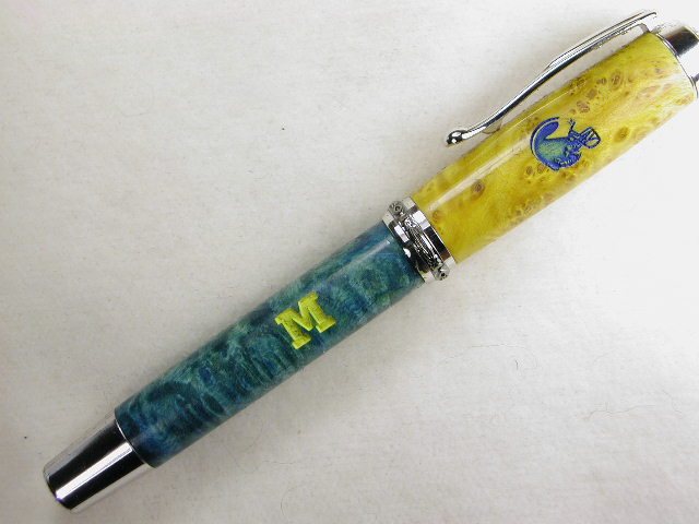

This is a pen that has been in the works for a while now. I need to send my thanks to Ken Nelsen at Kallenshaan Woods for the artistic engraving work because thats what made it all come together.
This is a Platinum Jr. Statesman with Box Elder Buri wood that was stabilized and died. The box was also engraved by Ken.

Good things take awhile and this one is a bute [:D]

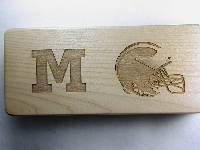

Very nice. How does the laser engrave look without the color? Does it work well like that too? I'll probably be trying some today. How is the color done only in the engrave? Did the engraver leave a tape mask on there for that? Thanks. Looks great.

Exquisite work, Wayne and Ken. I think the effect is breath-taking. Now in case anyone still has me on their Christmas list, I graduated from George Mason University...green and gold...no football team but a fair basketball team. :)

Bruce what you see on the box is without color fill. It has a brown tint. I really don't know how Ken does it but he had me make the pen and finish and assemble just like I always do for any pen..I then ship it to him and he does the laser engraving, color fill and sends it back within two days. Other than what I asked for there is no difference in the wood. I was a little concerened because I use a commercial Poly for a finish and didn't know what the laser would do, but Ken assured me it would be fine and by golly it sure was and is.
I just cracked up when my son first saw it, even though he knew what I was up to when I got it back from Ken and showed it to James (my son) he got down on his knees and bowed to Daddy and said that I was the greatest. I don't think that I could have bought anything that would have meant any more to him.

I laser engraved a turning tool handle for a guy the other day and tried putting tape on the wood before the cut. He was able to apply paint into the laser etch through the holes in the tape, then removed the tape which covered the wood. There was no cleanup necessary in that case. I wondered if Ken used masking for the color inlays or painted them in and cleanud up the surface afterwards. It can probably be done either way, but I haven't experimented with that.

Bruce beings that the pieces are finished before they are laser engraved they are easy to cleanup. I just did a color fill on the box that I had done to go with the pen and it was pretty easy.
Wayne
Nick Silva was telling me you can get the fill at a local crafts store and it should wipe off cleanly. Curious if you should put another coat of finish on AFTER you fill it in? Otherwise, won't the fill eventually break up and fall out?
The fill is an acrylic paint like substance. It does not fill the whole void, just colors it. There is still depth from the laser. I don't think that I would like it completely filled now that you mention it. I think that if you look at the photo that I posted you can see it.
