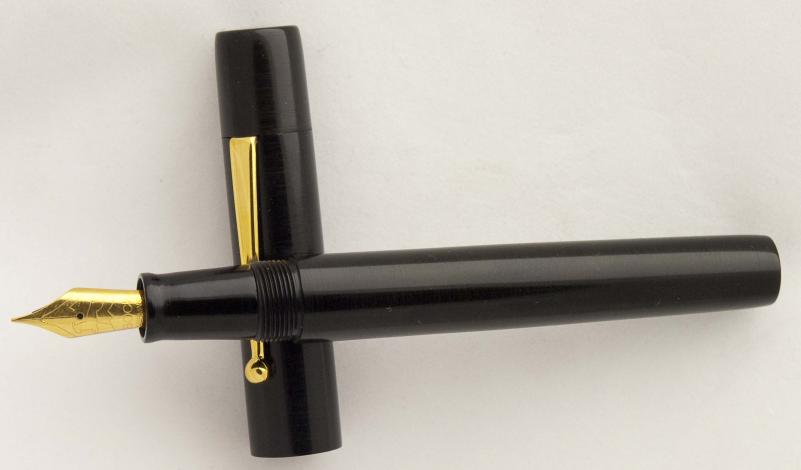

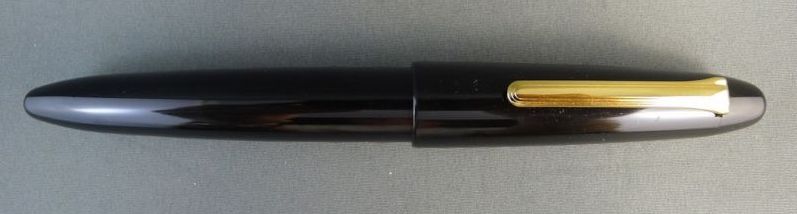

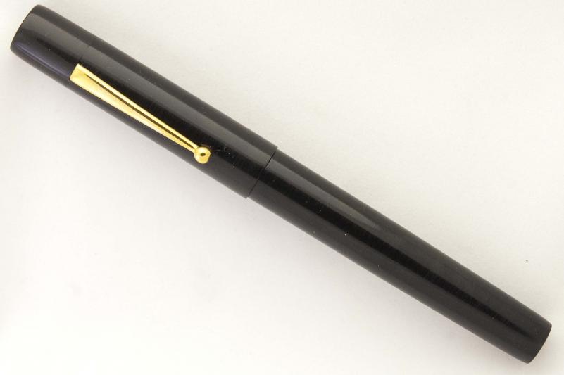

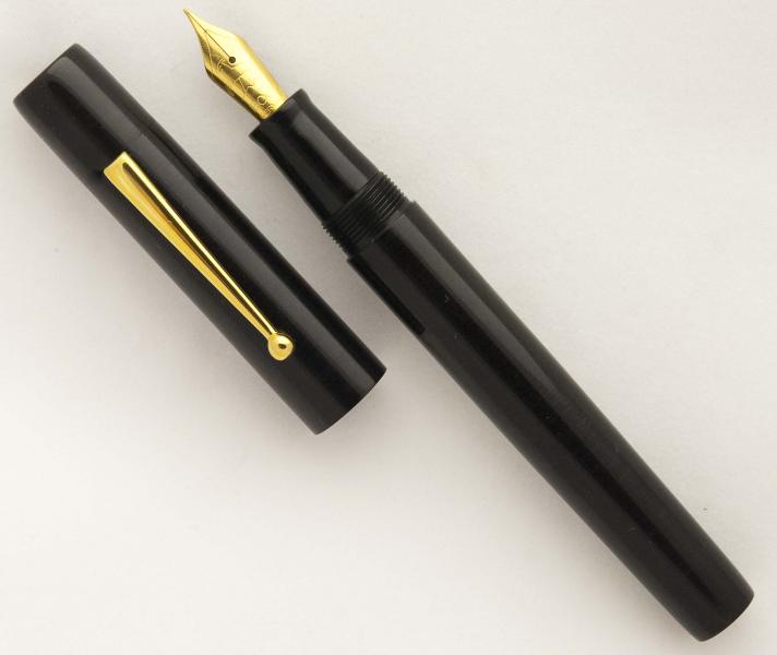

Made it over the period of last two A.M.s. Its black ebonite with a #6 Bock nib. All I can say about it is that it was fun to make and very black. ...oh and it did stink! :rolleyes: Hope you like it. Doc:smile:

I love the material and the finish! I'm just not a fan of the chopped ends, the low hanging clip , overlapped center joinery and the short section.
I DO love the execution, the design just does nothing for me. This reminds me of any FP that I can buy in in color in any stationary store.
I AM A HUGE FAN of your work, and I would be proud to own most of the things you have posted. I'm not trying to be hurtful, but instead helpful. I much prefer your earlier works.
Respectfully submitted.

LOL…Thank you for your candid feedback. I appreciate it. I understand a lot of this is personal preference. However, your comments are definitely resonant with my desire to further develop my skills. I am relatively new to kitless pen making. I am slowly trying to push past several areas that I am sort of stuck on with regard to contour, smaller finial, less overlap etc. This is a starting point for a pen from solid black ebonite that I have in mind. What I am ultimately aiming for is inspired by an instrument called Ebonite King of Pen by Sailor. LOL..I realize I have a long ways to go before I get there. Thanks for challenging me!

Great job on the pen doc!! Everything looks just right on this one......i might just have to start taking lessons from you before to long :) I like the long finial and the flat tops, looks old school, clip is in a great location, and the section is the perfect length, any longer and they start to look out of proportion. Dont think i could find a pen like this in a stationary store anywhere i live :) Keep it up my friend!!!

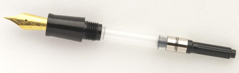

I love Ebonite and kitless pens. How about letting us in on the thread sizes. Also where's the clip from and how is it fastened?
Robert, Certainly! The threads for the cap to body are using 14 X 0.8 triple start tap and die. The threads for the section to body are using 10 X 1 tap and die. Regarding the clip, the finial is one that screws on to the cap with threads at 8 x 0.75 and makes the clip replaceable. The feed and housing holding the Bock nib screws into the section with threads at 7.9 X 0.6. The nibs and tap is available from Roy at Classic Nib. I'm still a newbie at kitless work. Pretty much everything I've learned is from Justin (Timebandit) and on IAP. Regards, Doc:smile:
