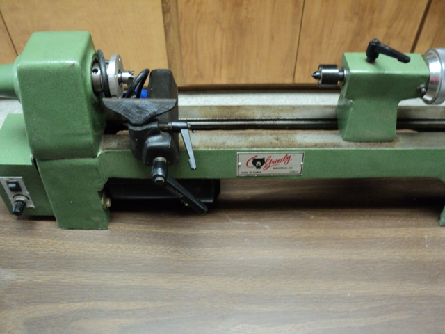

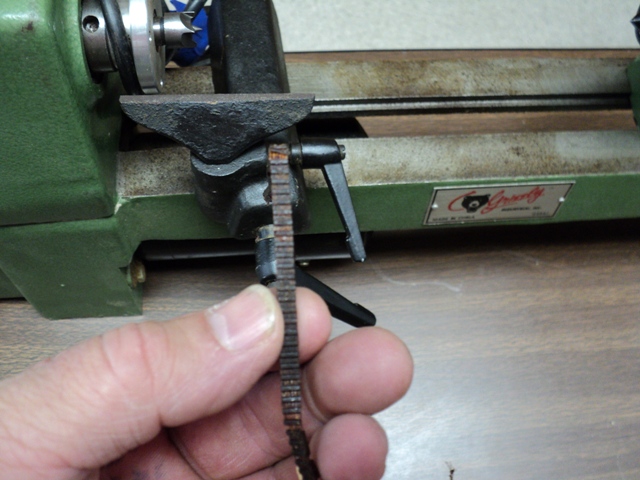

Well, pretty small. Thanks again for all of the input! Attached are two pictures of this little nightmare. I was not really aware that the v-belts were sized by mm so; I guess I need a 4M43.
Can anyone else help with a source?

That doesn't look like a v-belt to me, it looks like a timing belt. Are there grooves or teeth on the pulleys that the knobs on the belt fit into. Further supporting this is I cannot find a single mention of a 4mm wide v-belt anywhere. However, a T2.5 timing belt is 4mm or 0.157" wide and I can find it ready made in 420mm lengths. I can't find one that is 430mm. Is there enough adjustment in the lathe to allow you to use a belt that is about 1/2" shorter. There should be some adjustment to tension the belt.
V-belt
No grooves on the pulleys (sheaves) never have learned the difference, I haven't disassembled it yet, but there doesn't seem to be any tension adjustment. Where can I find this T2.5 belt x 420mm?

I use small belts like the one pictured. Try Powering Progress Gates Rubber Co. is one of the largest belt mfg. in the world.. Search their site for 3M500 (this is the belt I use most of the time in my design work, 3mm X 500mm) that will get you to the small belt listings. The ridges on the top of the belt in your picture, look like the ones on all the belts I use.

Using his information I found some better belts. I have been entirely unable to find a 4mm wide belt in anything other than a timing configuration, unless you want to custom order it. However, I did find some 3mm and 5mm wide v-belts in 425mm and 437mm lengths. They are Gates polyflex belts and the part numbers are 3M425, 3M437, 5M425 and 5M437.

According to Gates website the angle of both belts is 60deg. I am betting that your 4mm belt was the same angle. If that is the case the only difference I see is that the 3mm wide belt will ride lower in the sheeves and the 5mm belt will ride higer in the sheeves. If that is correct if you use a 3mm belt use one that is slightly shorter ie 425mm and if you use a 5mm belt use one that is slightly longer ie 437mm. If I was going to order one I would order the 5M437 to see if it works and then go from there. However, since shipping is the most expensive part of the cost I would probably order a couple different ones at the same time.
I have never used belts like this so I could be wrong in my assumptions, I have just been researching these online. If I am wrong somebody please correct me.
