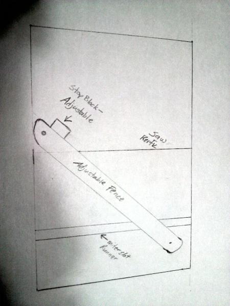

Does anyone have pictures of a sled they have built for miter cutting angles? I can't find or picture in my head how one would be put together/work to cut small pieces for blanks and such like the herringbone pens. Blanks that need small pieces cut with angled ends. I can see where a large sheet could be done fairly simple, but something even a little bit smaller (4x4 board) would need some sort of jig/sled. I'm racking my brain over here!
Grant,
Here is a picture of a miter sled I drew up for my bandsaw.It will have an adjustable fence and stop block.It can be made of materials you probably have laying around.The sled for mine will be 12" x 12" and the fence will be around 16".I will post pictures of it when I can get it done.I have been sick this past week and haven't been able to do anything.Cant wait to get back in the shop again.
