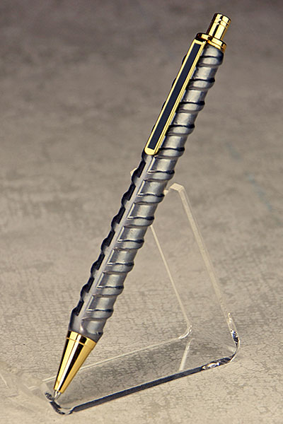

I picked up a piece of half-inch rebar a while back, and finally got around to making a pen from it. Upon discovering that 1/2" is a bit small for most pen styles (I should have bought 5/8" instead), I went searching through my kits to find one that would fit. The gel-click kit looked like it would work, and since I haven't made one of those before either, I decided to give it a try.
I turned down the centerband to tube-flush and pressed them together - converting the kit to a single barrel. Then I cut the rebar to length, drilled it, and turned the ends down to match the kit hardware. I powdercoated the rebar in smoke chrome color, assembled the parts, and this is the result:
attachment.php
I think it would look better with chrome fittings, but gold was all I had. Still, it was an interesting experience.
I hope you like it,
Eric

thats looks pretty cool! I bet that would look awesome with a bluing effect to it! Did turn the ends down with a metal lathe or is that a stupid question? LOL
Wow. Great looking pen, I think that I agree about using Chrome instead. How hard is the rebar to drill? The rebar almost looks to clean to be real.
Well, I was going to blue the rebar, but I couldn't find the bottle of cold bluing solution I thought I had. I might have powdercoated in clear except where I turned down the ends, the rebar was bright and no amount of buffing would bring up the same color on the rest. So, I broke down and powdercoated in smoke chrome - the closest color match I have on hand. The color almost matches the original rebar (if it were clean and shiny).
I had originally planned on buffing the gold plating off the kit parts as well. In fact, I did buff the centerband (before turning it down) to the chrome. The plating, however, held up much better than I've seen on other kits. I wasn't sure I could get all the gold off the clip so I just let it be.
I did drill and turn it on a metal lathe. It was just easier that way. The tailstock on my wood lathe tends to slide when drilling steel. The drill bit was shorter than the barrel so I had to drill from both ends. I really should have repointed the bit (118 degree) to a 135 degree split-point first. It would have cut cooler and easier.

BTW, what is the weight on this finished piece?
It's a fairly heavy pen, but not unwieldly so. My postal scale weighs it at 70g (2.5oz) - a bit more than a snakewood cigar (60g) but not as massive as a real 50BMG pen (100g).

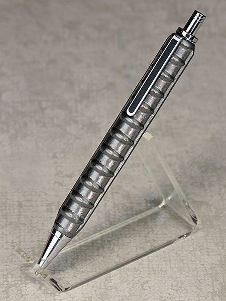

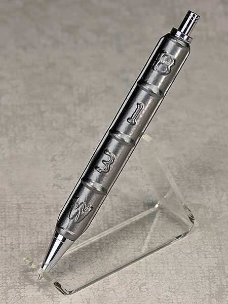

I made another one at a customer's request. He runs a company that makes rebar and sent me a piece with his trademark on it to use.
attachment.php
attachment.php
I switched to chrome hardware, and finished the rebar with smoke chrome powdercoat and a clear topcoat.
