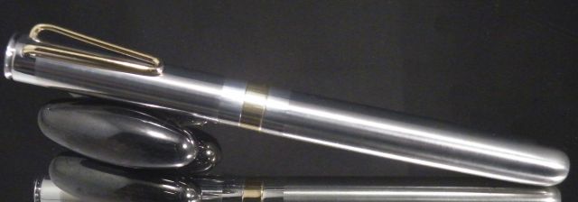

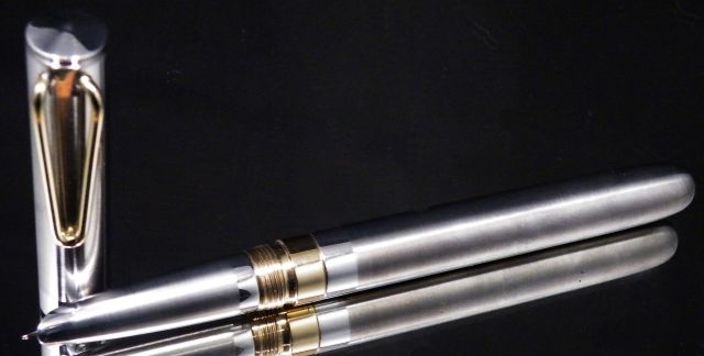

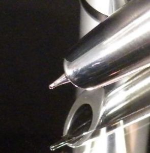

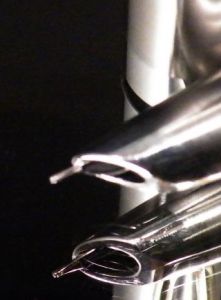

This is a Hooded nib FP made from Aluminum and Brass with a nib and feed and aerometric filler from a Chinese , Hero 616 , a Parker 51 look a like . I love this design and the Hero donor nibs/feeds write very nicely after a quick tune up . I used the sac and pressure bar from the Hero also (I forgot to take pictures of the filler system , I will post them over the weekend ) .

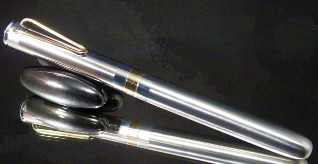

I'm still working on the shape of the hood but I'm quite happy with how these are turning out . I did a little different finish on this pen . I normally do a high polish finish on my metal pens but hate the fingerprints so I did a satin finish instead , I still think it looks like I didn't finish it so to offset that look I left high polish rings around the ends of the cap , the center end of the body , at the ends of the section with the nib end at an angle and the brass centerband/coupler .

That is excellent work Butch. :biggrin:Definetely one of my favourites of yours. Please tell how you masked the blank to seperate the shiny from the satin finishing. You got a very clean edge between them and I'd be very surprised if you just used tape to mask.
Butch, that is just crazy. I really like the hooded part and the finish,as well. I too would like to know how you seperated the your finish.

Skippy , you guessed it ... I just masked it off and then hit the pen with 0000 steel wool . You have to be careful not to get a catch on the tape , at 3000 rpm the steel wool gets wrapped up really quick :eek::beat-up::redface:

I love working with brass and aluminum , they are very predictable materials to work with . They turn easily and are very strong even when turned very thin . The only thing I don't like about them is finishing them . They look great when polished to a mirror shine but they are fingerprint magnets . I really don't like the brushed satin look by itself , it just looks like I didn't bother finishing it . Parker used brushed satin finishes on some of their Flighter series pens and they incorporated the polished ends which gives it a finished look so I just borrowed the idea .
