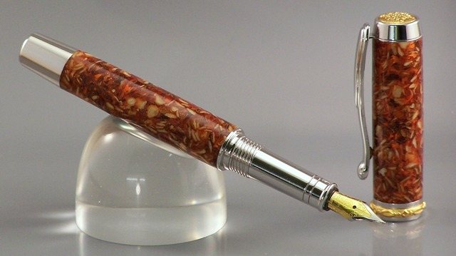

First is a Chilli Pepper ( By PR Princess )on a Jr Statesman. I don't normally wear a respirator so my nose soon told me what this was made of!!!:D This one is my favourite of these 3.

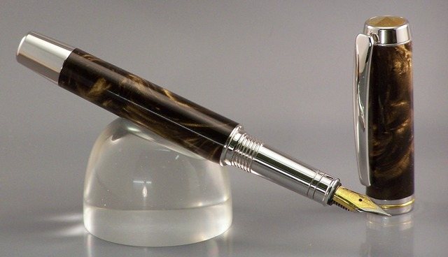

Next is another nice resin from PR Princess on a Jr Gent.

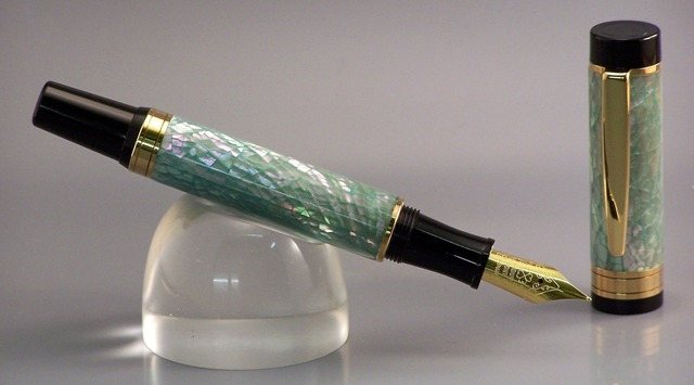

Finally, an El Grande with Green Abalone. I'm pretty sure DC Bluesman gave me this kit.
Comments and criticism always welcome[8D]

The Abolone is awesome, did you get that from Lou as well as the kit?

The red pepper pen is "HOT STUFF"

Mark, yes Lou gave me the blank with the kit. I don't know where he got it from, but I think AS and Berea keep them though.;)
I was a bit worried with it at first. It appeared very soft and you could easily scratch the surface with your fingernail. But it turned just fine and was obviously hard inside.

By the way, beautifull pens!!! What did you use to finish the pens?
That chilli pen gives me an idea. Maybe i must make one for my co-workere that keeps chewing his pens![}:)]:D
Carel. No finish on solid plastics. The chilli blanks do need some treatment to stabilized them as you turn. Just a coat of CA, sand a bit, CA some more, sand a bit etc etc. Final coat of CA when finished.
For solid PR's I just sand down to 1500 wet 'n dry then a bit of rubbing compound to get any fine scratches out. I never let the PR get hot during sanding or buffing. I can't get a nice shine if I let it get too warm.
