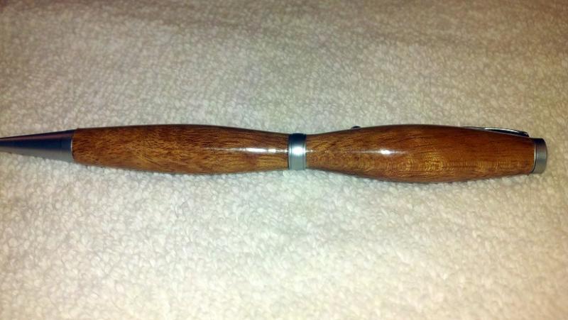

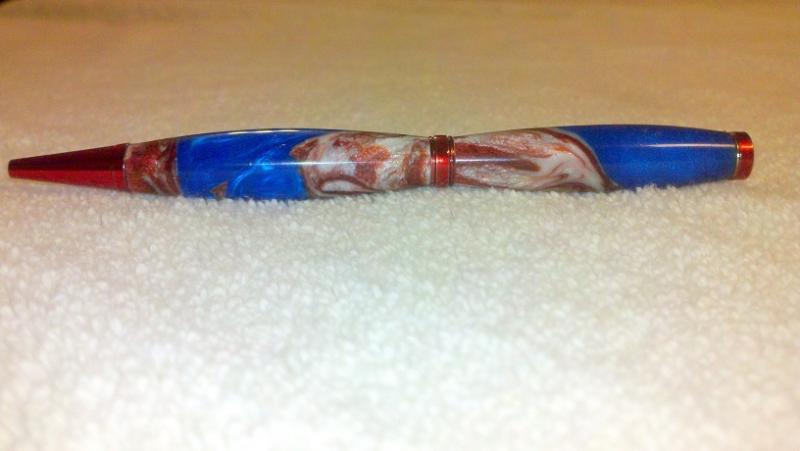

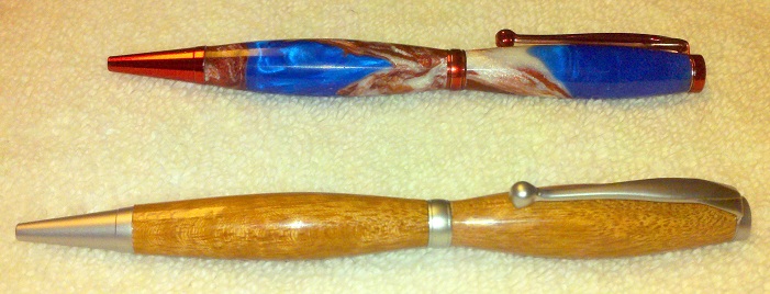

I wanted to make a pen for a customer of mine and well ended up making 2 of them. These two blanks came from brooks803 (not sure if yall know him) lol. Anyway he sent me a little package and it had these in it. Not sure if the acrylic is his or not. He didn't say so Thanks Jonathon:biggrin:
The wood blank is Goncalo alves. I rather like this wood it turned out to be a pretty color. Let me know what Yall think. I started to put the red tip on and a blue clip. Might try this one day.

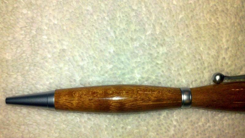

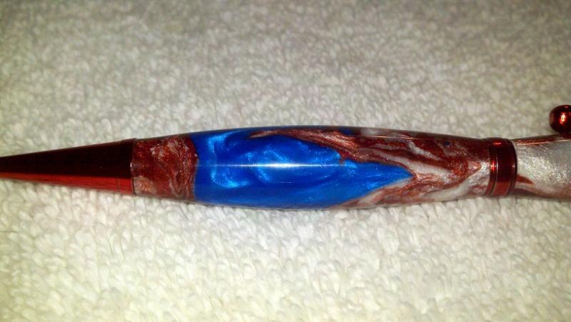

Finish looks good. I would keep working on that fit before working on getting customers. one thing you can do is if you find you overturned the nib like you did on the acrylic, you can tap out the nib and sand back or trim back the nib end of the barrel for a perfect fit. That's what is nice about slims, you can fix the oops a whole lot easier. Keep it up. You're getting there.
I am sorry I should have been more pacific on what I was saying. It is not for a buying customer for pens it is for a customer in my plumbing. Company I know that I am no where near ready to sell my pens. I just like handing them out for now. As you all know them may not see the little imperfections but I know they are there.
I still think you're off to a hell of a start Chris! Your CA finish is getting much better. I mighta done that black a while back, I know I didn't make all that I sent you though. So it could be someone elses.
Thanks I think I think it is coming along pretty good. I just really enjoy it. I have had other hobbies but this one is probably my favorite :biggrin:
I would do what Eric suggested about sanding them back if you over turn but you can also build up a little CA so you dont have to sand back so far. What I like to do is sand down to the bushings then go a little further then I just kiss the wood at the bushing with a homemade parting tool from a sawzall blabe to to take it just below the bushings. Then I CA the pen up until my Calipers will not go around it. I clean the bushing off and seperate it from the blank that way if it is going to stick I can fix prior to sanding. Sometimes a light tap around the bushing w/ some pliers will break the glue free. Then I take my parting tool and clean all of the CA off the bushing then I sand the lip away wet w/ 600 grit. When I am getting close I stop every once in a while and test w/ the calipers. Once it is on I move to the next blank if it is two pieces. When they are very close but not to far I move to MM. I like to take it to final w/ the 1500 then light on all the rest not to remove material just cover scratches.
