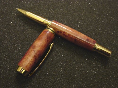

This is a blank of Camphor Burl from Dario. The finish is CA using the Fager method. Comments wlcomed.

Thanks for the comments everyone.
Alice I don't know if they are the same size. I don't have a kit of each to compare at this time. I know the directions for a Gent II call for drill bit sizes of 12.5mm and 27/64 and the Baron uses 15/32 and 25/64. Not sure of the length though both call for a 5" blank. Sorry I can't be any more help.

<br />beautiful! Does the Jr Gent have the same brass tubes as a Baron?
Unfortunately, no. The Version 1's were the same size but for some strange reason CS USA increased the diameter of both tubes when they came out with the Version 2's.
