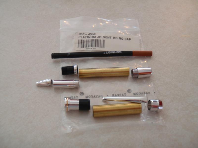

Bruce, I got a few of the Jr. Gent I kits from Chasper a while back with bushings. Just this AM I checked the dims. because I was going to get some Barron tubes. The bushings I got from Chasper correspond to the ones you have from Smitty and yes the tube lengths are the same. Perhaps Chasper can chime in on this.
CSU #050-4508 Platinum JR GENT RB SMOOTH CAP
Body:
Nib holder Ring: 0.480
Non-posting end cap: 0.461
Tube 1.812 L x 0.454 OD
Cap:
Cap ring: 0.536
Cap finial: 0.533
Tube: 2.093 L x 0.381 OD
Bushings:
Cap: 0.535 x 2
Body: 0.481 & 0.471
Body:
Cap:
Cap ring: 0.536
Cap finial: 0.533
Bushings:
Cap: 0.535 x 2
Body: 0.481 & 0.471
