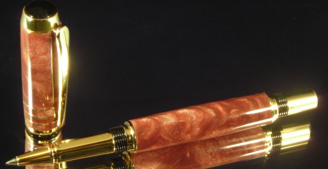

Ron , here is a picture of a Baron I modified the CB on . By the way the Baron is the same design as the Jr Gent basically , just a little smaller

Butch, Your work is absolutely spot on amazing! I looked at your gallery after you said it was mostly kitless. Like probably most, I have a list of penmakers from this site that i REALLY try hard to learn from simply because of how nice their work is. YOU, my friend, have worked your way up that list!
I remember discussing some mods with you a while back, but had no idea your skills were so incredibly advanced. Just to have something worthy of submitting to PMG. I SO want to be like you when i grow up! Thank you for sharing your amazing abilities so freely!
