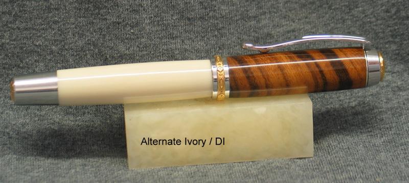

I like alternate ivory (Exotic Blanks) for this. Sorry, no mallee burl, but I swapped a DI cap just to show an example:

I think the oops band usually looks out of place. I would fill the blow out with colored inlace. You can also go back to the other blank section with a dremel and make a couple little oops gouges into it and fill those with the same colored inlace and end up with a worthless wood sort of pen. Probably even make the pen look better, because Brown Mallee Burl is usually not all that exciting to begin with in my opinion anyhow.
