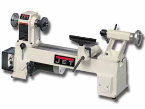

can you add a speed control on a Jet Mini Lathe? I know there is some with them. I just bought mine about about 2 1/2 months ago, but no speed control.
The pic above has the speed control.
Jet makes a retrofit kit for the Jet Mini Lathe. Below is a link to the PDF and information on it. I tried googling it to find a retailer but no luck. You might have to find a local Jet vendor to order it for you.
http://wmhtoolgroup.com/partfiles/m_708351-VSR.pdf
You should be able to call Jet directly to either order the kit or to be directed to a local distributor who can order it for you.

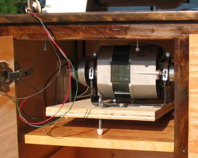

The above is correct, there is a kit from Jet. However, the kit includes a motor to go with the controller, since the non-VS motor is AC.
I went a different route with mine. I bought a surplus DC motor and controller, and installed it inside the cabinet, right under the lathe head.

Brian, I think you will be happy with your motor and controller. I am using a similar setup. I mounted my motor under the lathe, in a cabinet. Photos in my album.
As far as the fan goes, that pulley has a centrifugal fan built right in. It also has a Poly-V pulley.
