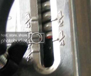

I took a look at mine and it sounds as if you are reading the tension gauge figures incorrectly.
5/8" is on the bottom of the casting and graduates to 1/2" then 3/8", 1/4" and finally 1/8" is on top. The smaller the blade, the more tension.
I have the 6" riser and am usin 105" blades. I do not have a problem with the threads. Prior to adding the riser block, I did have a wheel tracking adjustment arm, located in the same area, break and I had to order new parts. I was running too much tension and had a 3/4" blade on it. When it worked, it was super. Now I stay with 1/2" or less.
Check the tension figures you are trying to set.
Originally posted by beamer
<br />That's weird, Jim. Mine goes the other way ... The smaller the blade, the LESS the tension needed.
Man do I need to get better glasses...that must be the problem all along besides another senior moment...
Absolutely correct (and I can post a photo if necessary). The scale is graduated with 3/4 on top and 1/8 on the bottom. Less than 1/8 is just plain loose.

Here is the tension block photo. Not the best - macro - dark shop - handheld but you can make out the numbers - Right Beamer?

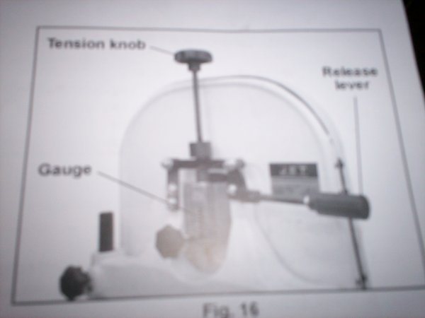

Let me add this is the Jwbs-14DX model which (as far as I can tell) is the same as the regular band saw but this one has a quick release lever.
<br />
I know the picture is bad but it might give you an idea of the setup.
Beamer: Yes the screw and the nut were replaced. By locking up I mean the threads get messed up and the nut will not turn either way. I've had to cut the screw in half with a hacksaw to get the other pieces off. Also the spring while compressed to about 1/2" is not fully compressed. The threads are messed up buy just hand turning the knobs (no tools used on it).
