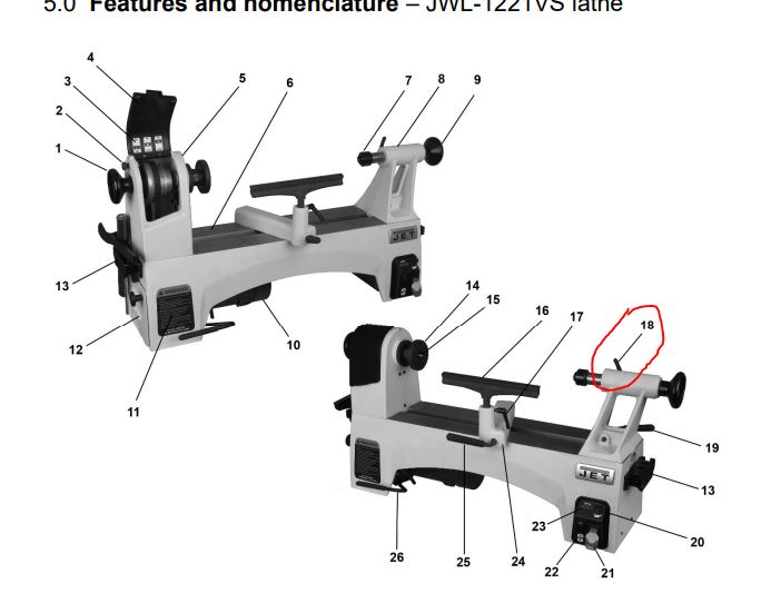

Hi Folks:
I am going to call into Jet once they open, but has anyone dealt with this (loose quill locking handle)?
Thank you.
keeps loosening. thx for the question.
the jet technician recommended a light threading product. I order a new handle, although it may be the female threads.
I had what sounds like a similar issue with a turncrafter lathe a couple of years ago. I called PSI and they said it was likely the female threads that had gone back, apparently a not uncommon thing because the threads are castiron. They had tailstock as a replacement part (just the castiron part) and that totally fixed the problem.
