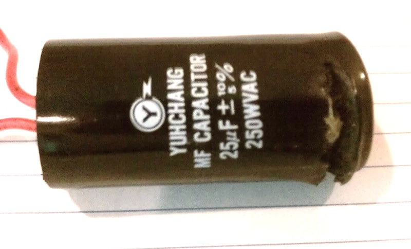

Finally smoked the capacitor on my Jet. Didn't like the $24 option from the factory so I went to Granger and picked up a 25uf 250 VAC cap to match the specs on the old one for $5. Installed it and I was back in operation. After about an hour and 6-10 starts, the new one is smoking. I read something on another forum about problems with the switch not taking the start cap out of the circuit and causing it to overheat. Is something wrong with the motor that is cooking the cap? Help! I haven't been able to finish a pen in over a week!:confused:

The start switch and start winding are in series. The switch is closed making contact when the motor is stopped. At 3/4 speed it should open. When motor stops the switch closes with an audible click. If it does not click it is stuck or welded. This will overheat the cap causing it to swell.

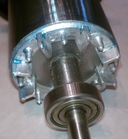

To access the start switch: make reference marks on each end to help line up endbells and motor body. Remove non-shaft-end endbell. Clean or repair switch being sure that you haven't pulled any wires loose, Reassemble and tighten bolts while turning the shaft. Tighten opposite bolts in a staggered pattern. Tighten in about FOUR steps.

  • Motor parts supply guys said it was a start cap so I picked up 2 with the same specs as the Chinese one I was replacing since they were only $3.60 each and cheaper than the gas to come back for another. Installed new cap under the cover and started turning again. Melted it as described above

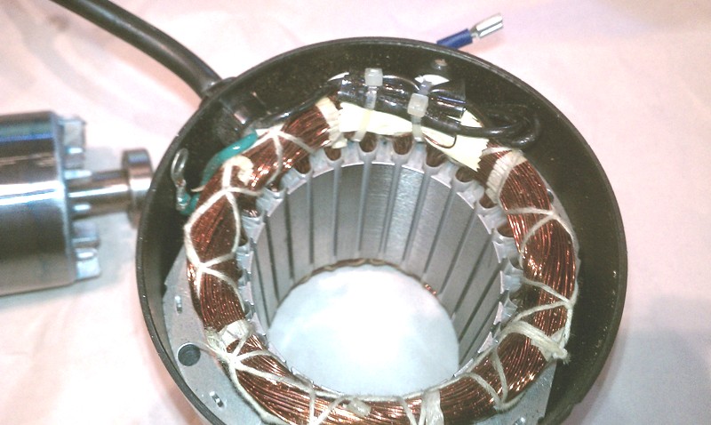

  • Opened motor case according to the guidance above. Didn't see anything that looked a centrifugal switch that was stuck, or any other type of capacitor cut out switch. See photos of inside of motor.
  • Went back to motor parts guys and asked for a run capacitor, instead of a start. My clue was the 250 WVAC on the original cap, indicating working voltage AC - I read that this is a usually found on run capacitors. Parts guys scratched their heads and said to call them back and let them know if it worked.
  • Installed on the motor - good as new! Several running hours later, no problems! Cap was completely cool :biggrin:
I haven't been able to find a run cap with the right specs that will fit under the little cover on the side of the motor, but that is not a problem for me. This is a nice industrial quality aluminum can (just slightly larger) Plenty of room to mount near the on/off switch. Sooo - if you cook your aging capacitor, find a local motor supply or Granger mail order and get a motor run capacitor for $5 -- or send $25 to JET's new owner and maybe get a smaller like the one that melted. :tongue: I don't mind making mistakes as long as other people learn from them.:biggrin:
