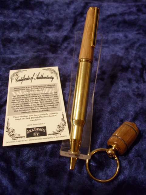

I bought some of the JD Blanks from a member on here and received the certificate with them. Made the pens and some keyrings and have them advertised on my website using a photo with the certificate . All was well but I have now received emails from someone saying they work for Jack Daniels and telling me I have to remove all pics and mention of the certificate. Anyone have any Idea how I stand with this as I do state that they are not officially licensed products but I would still like to sell them with the certificate but I don't fancy fighting Jack Daniels. Anybody???
Can you give us a link to the website page in question? We may be able to give you some advice. Right off the top of my head, I imagine that it would be an issue if you have a picture of their logo or a bottle of their product. Also, the wording that you use could be an issue. When we sell these, we state simply that they are made from a JD barrel rather than calling them JD pens.
I have already altered the site as there was some pens on that I had called Jack Daniel's pens but I also had a picture of it with the certificate and that seems to be the problem. The fact that it has the badge and correct font. There is a picture on Martin's handturned pens and gifts - Pen and Keyring Sets and it shows a pen , keyring with the certificate.
Just to clarify this is NOTa dig at suppliers I was just wondering if anybody else has had this problem.
I would not include any image of their logo or their font. If they are on your CoAs, than I would not have the CoAs in the pic.
"Jack Daniels Pen" will result in a penalty flag. "Made from a Jack Daniel's whiskey barrel likely will not.
This is a Trademark issue. Without explicit permissions, use of trademarks puts one into a place where infringements can become expensive.
The statement above describing the source is factual rather than one using a trademarked term as a descriptor.
Note that trademarks are enforced by the holder, and they have to protect the trademark or risk losing it.

I had a look at a photo in your IAP photo album and if this is what they are taking exception too, Personally, I would think twice about using it.
It's a little hard to read but I believe the caption towards the bottom says....
"These turnings have been carefully crafted to match the Jack Daniels Distillery level of excellence"
To me that implies the turnings themselves were made to Jack Daniels specifications and looks like someone took a little liberty by adding a few lines of their own text to the certificate. This goes way beyond just using some wood from used oak barrels.
Here is the photo I saw, is this the one that was on your site causing the problems?

I think the problem is with the COA, not the fact that it is a pen made from a JD barrel. I had a look at the COAs of JD blanks supplied by other vendors and they are nothing like the one you have. Their COAs are plain and just state that the wood used is from a JD barrel.
The COA you seem to have has a couple of lines that might imply that JD had some direct involvment with the making of the pen. Plus the blatant use of their logo and font. They are protecting their trademarks and reputation.
