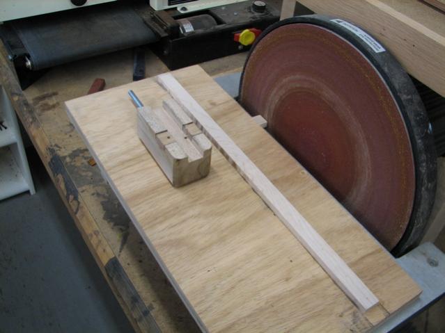

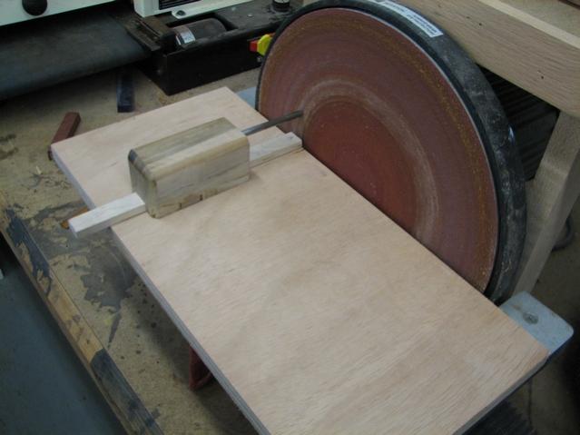

I agree that this is a good tool and when I first started it was one of the first things I made for penturning. I used it with no problems for a long time until I started making some of the longer pens. To get around this problem I still use the same basic tool but I cut off the crossbar, cut a dado in the bottom and mounted it on kind of a rail system. With this setup I can still move left and right so as to not wear out the disc and more important I can move in and out for different length barrels.
Here's a couple pics that show the top and the bottom.
By the way, I use the same sleeves for this and my pen mill.
