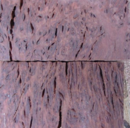

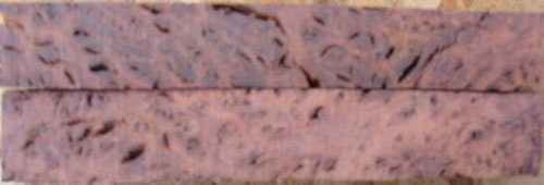

I have a lot of jarrah that has cell collapse, is there an interest in these blanks for casting? The blanks are solid and I think they would look cool with the holes filled in. It seems like finished blanks go for about 6-10 bucks each seems like it could be profitable. What would be a good price for the pre-casted blanks?
It'd be tough to cast those without having to double cast on the bottoms as the holes don't go all the way through. Even with vacuum, air pockets get trapped on the underside. Those are great looking blanks, though, and would be worth a double casting, or even filling in place on the lathe with CA type stuff.

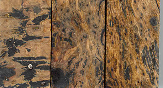

Sorry Karl but I am going to have to disagree on this one. They can easily be fixed with Alumilite Black with one cast and will look good when done. It would be well worth it and would add value to the blank, IMO. I have done quite a few in a condition just like this and they all had very good penetration. Here are a couple of pictures of some Spanish Oak Mistletoe burl I cast just this evening. It was in basically the same condition as Issac's blanks and I got complete fills. Here is a large view of three blanks...

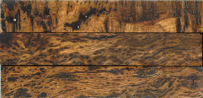

Here is a close up showing the filled areas better...

Wow, that's surprising! I've been having trouble with holes being filled on the underside without trapping air pockets, at least on holes that don't go all the way through. I wish I could see what was going on in the pots under vacuum and pressure. Does the resin get sucked or pushed 'up' into the holes?
Karl,
I think there are several reasons I am having success with this...one, I am using Alumilite RC3 Black which is MUCH thinner than regular Alumilite or PR. Second, I am heating the blanks to 200 degrees and casting with them hot. This helps thin the resin even more and seems to helps pull it deeper into the wood. Also, not sure what pressure you are using but I am using 80 psi which forces more resin into smaller spots. I used a piece of MDF in this mold as a filler to keep from using too much resin and it penetrated the MDF completely! I now have a nice black piece of MDF!
