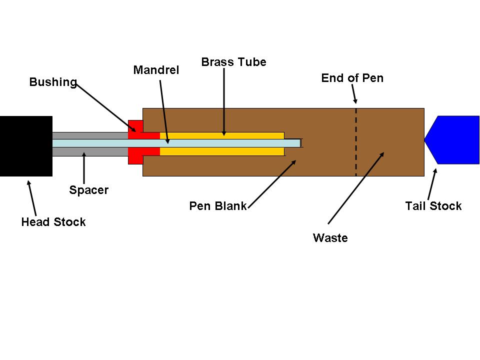

Hello all, well it is time to try my hand at closed end cigars and I was wondering which you guys thought would work best for holding the closed end pin chucks from AZS, a jacobs chuck or a collet chuck like Beall or the PSI version? Currently I do not own any kind of a chuck.
Hey Larry,
You should contact J R Beall at Beall Tool Company and get a replacement...or complain to the vendor where you bought it. There should be minimal runout. I know others who complained and had the problem fixed.
