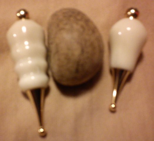

I got the plant ivory nuts. I couldn't wait to throw some on the lathe. So, I made a few Christmas ornaments real quick. I think I'll try to glue up some segmented pen blanks using a few of the others with brass foil in between.
It's really not bad to work with. The outer shell is pretty hard. It's a little weird to turn. You have to be really careful and take very small bites. The first one I did, I accidentally let my tool get below center and when it got pulled in to the material chunks flew everywhere. The noise it made when it crashed into my face shield made me very glad I had it on. So, I just turned it a little smaller than I had planned (very slowly).
The first one (shorter one) I turned, sanded with 80, then 120, then 220, then 400, and then wet sanded with all 9 Micro Mesh pads and polished with Hut Plastic Polish.
The second one I turned, sanded the same way, but added 3 quick coats of thin CA prior to the Micro Mesh and polish.
The second one is not any more shiny or glossy than the first, it just doesn't "feel" like natural material anymore. I won't use any finish on it in the future.
It is absolutely beautiful and I am very happy with it for the ornaments! I can't wait to try it out on pens...
Only time will tell how stable it is :)
Sorry for the crappy cell phone pics, they don't do it any justice. That is one of the "nuts" between the ornaments.
BTW - Don't drill too fast or it stinks like heck and discolors the ivory. Luckily I didn't turn that deep into it.
