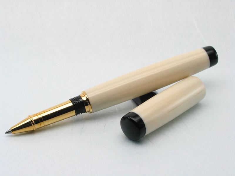

Exotics..Alt. Ivory is pretty nice stuff. It has some really nice gentle banding and a great creamy white color. Here's one I did with it..

I met with the factory rep at Chicago last week and he told me that the thicker the material, the nicer the grain. I never knew of this characteristic and I always try to avoid buying material I am going to "turn off". But, you may want to try the one inch and see. (If you don't like the pen for this purpose, just sell it--on decent hardware they SELL WELL!!) Then, make the real ivory and pray it doesn't crack.
Casein is nice, but with the vertical, somewhat irregular lines, it will never be mistaken for ivory. There is also Alternative Bone, which is whiter than the ivory. To each his own--buy three of each, take your wife to dinner with the money you have left over cause you did NOT buy ivory.
