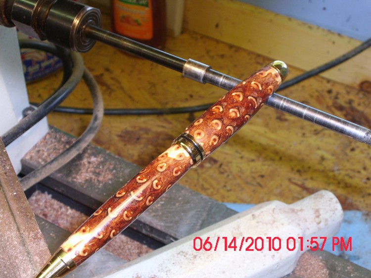

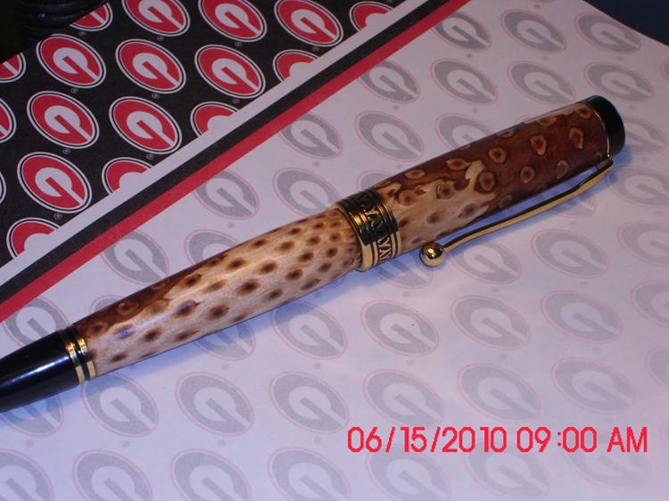

Made this one out of 2 pine cones from my front yard. I haven't seen a pen quite like this done in pine cone. The missus asked me NOT to go down and do battle with pine cones, as it usually results in thrown objects and profanity. I was feeling pretty gutsy and decided to try to do this, and the challenge was in getting the finish down with the ends hanging free without sanding back through on the edges. I couldn't really tear into the CA like normal with the finish, but it's still decent. I like this one, and it was a LOT less stressful than the last time when I swore pine cone off until reasonable money was on the table. I did remember to stabilize with thin CA as needed as well as keeping a sharp gouge.

From what I gather it's best to stabilize them with lots of thin CA which helps in turning and finishing. Also the bigger the cone the better. Not sure what you used but sugar pine cones have a good amount of meat on them.
They do make for some neat looking pens. Good job on yours

I'm pretty sure it's longneedle pine. Huge cones. And I get a few dozen every year in my front yard. I've done a good handful before, but it's been a good while. Last handful of attempts went horribly, horribly wrong in spite of flooding with CA, using good cones, etc.

Thanks! I haven't encountered banksia pod yet. If you want some pine cones like these, I can probably help you out. My tree is still shedding them. They just need to be drenched with thin CA repeatedly and handled as if very fragile. That top barrel is the diameter of a 30-06 round, so you can imagine what else could be done with it.

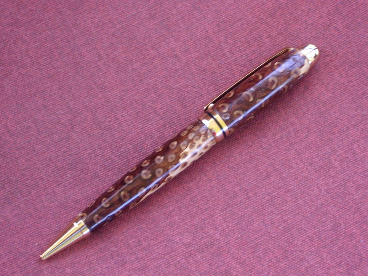

I do pine cones quite often: they are time consuming and rewarding at the same time. here is a trio I have done in the past.
