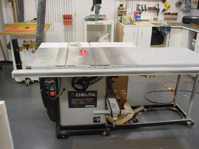

I suggest you buy the biggest honking table saw you can find. Bring it home. When she sees it and freaks out, you tell her you will return it and get something smaller. Than get the 10 inch table saw again and you are all set.
Something like this:
