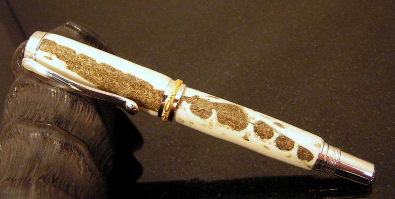

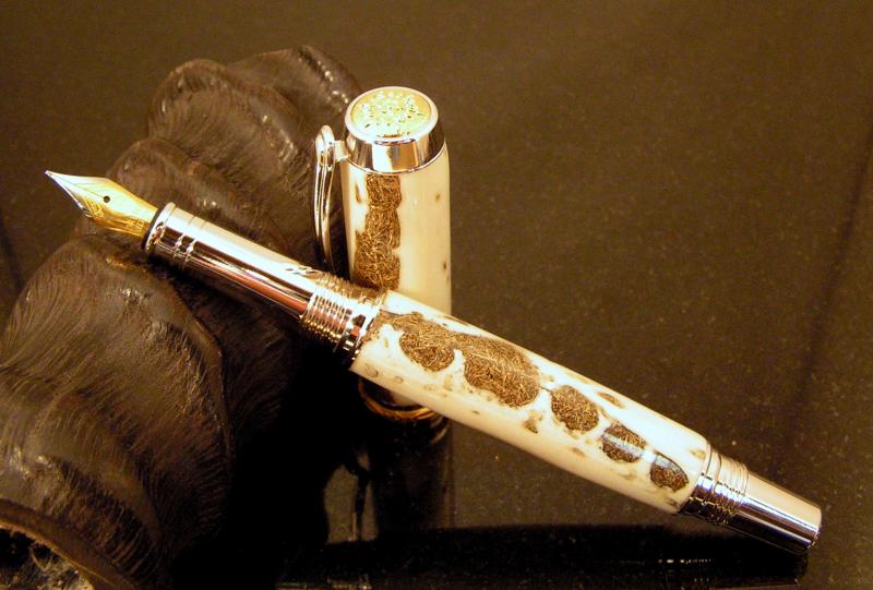

So I finally got around to trying to do something with it. Well, not actually kicking around. Even thought he was not one of the "big boys" I still would not have wanted him underfoot while I was working.
I did not cast this one first, it was all done dry on the lathe with lots of CA and some of the stuff I traded the guy at the hardware store out of when he was cleaning out from under the key duplicating machine. Not sure that is the optimum approach as I lost some of the detail of the upper tube that I might have been able to keep had it been embedded in alumalite. Not that the individual socket structures were all there to begin with, but there was more than ended up in the finished pen. Live and Learn. It did eventually smooth out and take a nice polish, but I used LOTS of ca. Anyway, let me know what you think!

James, buddy, I am lost you only live out side the loop 610 in Houston area. where did you get the gator from. I lived in Houston and I don't remeber gators unless you guys let them in after 1986 when I left. Heck, who knows what you can find in Houston nowaday. Anyways, You said it' sthe jaw bone then, where the brass spots are, should be the teath cavities? Ok, then, can you explain how you did this pen on the lathe dry???????????? how much CA did you slap on there to make the hills and vallys go away? Or, am I not getting it.

As for how to make a pen out of one without casting it in resin first, I cut the sections and squared the ends, then glued a slice of 1 inch dowel to each end. Then turned the whole thing close enough to round that I could get it in my scroll chuck and drilled through the wood on the other end and through the bone . I then cut the wood off and slid the tube in, and glued it into place with thin ca. Then I piled the brass shavings into the holes and soaked them down with med ca. let dry, turn down, repeat till all voids are filled. Sharpen skew repeatedly! bring to final shape with 80 grit gouge, and mike ends with dial caliper till they match components. Sand with 220, and refill any newly discovered voids. eventually it will get smooth enough to sand to 320, then apply finish coats of med ca, mm to about 8000, buff with eee and white diamond, then polish with meguiars swirl remover.
