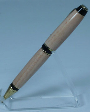

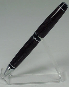

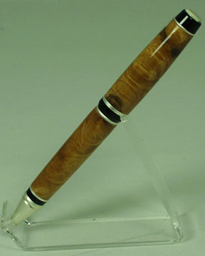

Shown are three pix taken with my Olympus C-2500L SLR 2.5 megapixel camera. There were no changes made to camera settings or lighting between the shots. Only the pen was changed.
This is the way the pix came out of the camera. The pix have only been cropped and saved as jpg. No other PhotoShop effects have been applied.
Has anybody have any idea what is causing this effect and how to fix it (other than replacing what is sitting on the tripod)?

Do you have a white balance setting on the camera? If so, there should be some instructions in the manual about how to set the white balance. That should help.
Your camera is set to "auto" white balance, which is the default on most cameras. Your camera probably has a setting to change it. You want to change the setting to match your lights, or (if your camera has it) choose the "custom" setting where you fill the frame with something white (your background should work) and press a button to "set" the camera to recognize it as white.
Yes, but I didn't change it between shots. I can fix it to some degree with WB in PhotoShop but it still leaves a tint to the overall pix.
Are you saying that the WB adjustment, if set properly on the camera, would automatically correct the color for each shot?
You answered while I was typing the above reply. I'll try that. Thanks
Along with White Balance, I also prefer to use manual settings for aperture and shutter settings too, that way, the only thing changing is the pen in the photo and the exposure isn't affected by the change of color from the subject.
