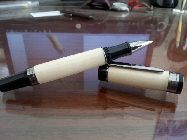

White is back in style. I was'nt even going to show this one but RSidetrack posted his Ivory Alternate which is awesome. Anyway here is an El Grande with Stabilized American Holley and 3 coats of CA. Very plain and basic but it seems that is what people are buying latley. (from me anyway) Comment s welcome. Have a great weekend. Jeremy

I had that problem before as well. Used clean water for ecah stage of sanding. Sanded to 1500 wet. When I was done wiped it down with light coat of denatured alchohol and let air dry. Then three coats of Med CA polished to 12000. Standard stuff. Just got lucky I guess.
Sometimes the simple elegance of plain colors such as that go well beyond the wow factor of colors and swirls we all look for in the acrylics and burls.
Beautiful pen!
