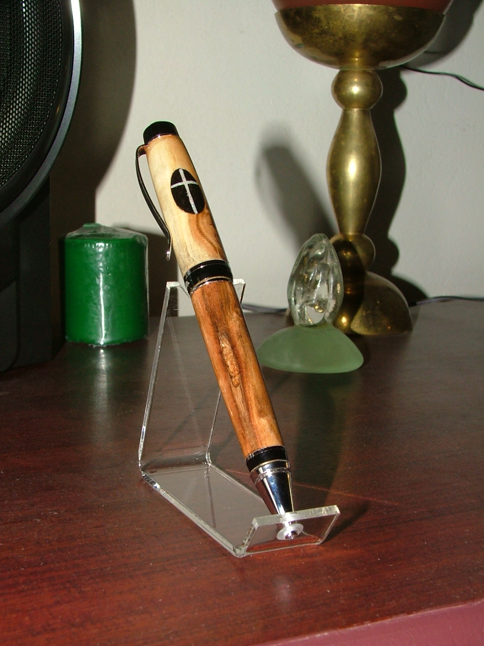

I am making a pen. But first a bit of a story. My Uncle will be turning 70 next month. This is that sort of Uncle that was your favorite when you where growing up. He had a son and a daughter. His son Troy was one of my favorite cousins to hang out with during the holidays and what not. Many happy memories with Troy. When we grew up Troy became a very accomplished Pianist and Pastor. When he was 22 he was killed in a head on car crash. Larry My uncle planted a cotton wood tree in his front yard and called it Troy's tree. Trudi, Troy's sister called me a couple of weeks ago asking me if I could make a pen from a piece of Troy's tree. Something with a religious them. My first thought was Eagles Cross. I sent her a photo of an example of it and she loved it. I now have a blank cut from a limb that was barely big enough. the blank is cut and the pocket hole is drilled for the cross inlay. I have now spent two days in the shop trying to get the inlay right. I am close but still not good enough.
The combination of the importance of this pen. the significance of the material and the challenge of making the inlay has brought an enjoyment to making pens back that I have not had in quite a while. Thanks to Eagle and his "Get off your but and go to the shop" SECRET! This will be a pen I will never forget. It is going to be a cigar pen made from Cotton Wood. Nothing special on the surface, while I have never made a pen more important. It is funny what can come together to make a project really count.

Dale, Originally the idea was for the cross to be a walnut background oval with the cross made of the lightest wood from the Cotton Wood. I spent the entire day trying to get the cross down. the cross part I have but the oval is not coming out oval. My drill press is simply not accurate enough to get the hole drilled straight to the center of the blank and jsut a little run out masses up the oval really bad. so plan B is I will hand carve the oval after the barrel is turned just proud of finished then fill it with Ebony dust. I will then hand carve the cross and fill that with crushed opal. I know I can do the hand carving and simply do not have the time it will take to figure out the cross Eagles way. I will not give up on doing one just because the old fart has ticked me off now.

How about using a dremel to carve out the needed area. You can get straight edged bits, similar to a router bit. It would probably be easier then a scroll saw, as long as the barrel is in a vise.
Thanks everyone, It took 14 hours but I finally got it with the Dremel. Not exactly Eagles cross, But i think he would approve of it being that way. Here is the photo so that people don't think it is all story. I am pretty proud to say that inlay is hand carved.
Sorry the Photo is not better.
Inlay ended up being Ebony sanding dust and Opal dust for the cross.
very nicely done. glad you found a method that worked for you! sometimes the journey is the point, but you got a very nice ending as well.
