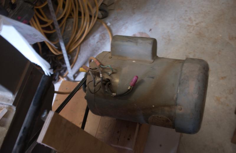

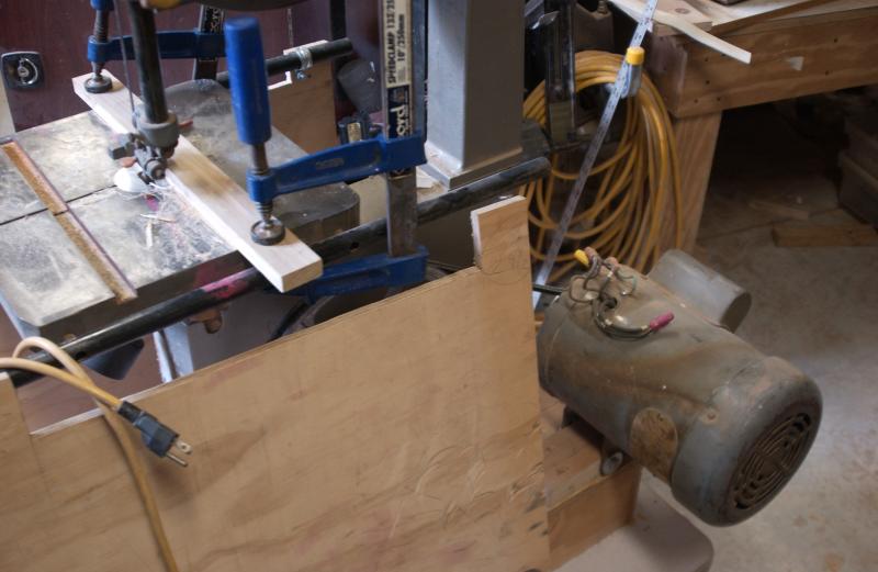

I have never seen that brand -- but 10 amps is 1 HP in most honest equations - so you are looking for a 1/4 hp motor. That is in the easy to find size range. I ran a sears 80 inch for years with a 1/4 hp motor (Just could not hog anything).
As note above you may be able to repair,
You will want to know the shaft size, and RPM and the mounting pattenr (NEMA Codes help with this) to get a replacement with the least hassle. You can use a larger motor if it can be made to fit -- say a 1/3 hp.
I note That Surplus Center has 1/3 hp 1750 reversable AC motor for $70 plus shipping. I have had success with salvaged motors from washers and as they are 110 volt motors about 1/4 hp. sometimes have to be creative for mounting -
