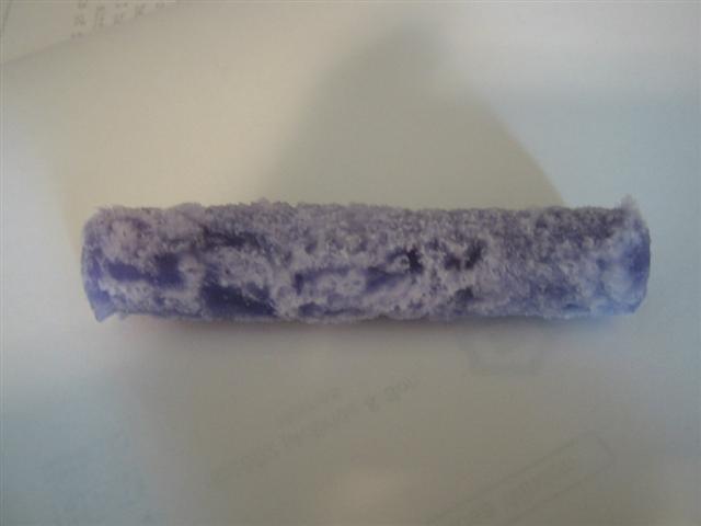

I made a pen out of a pink twine awhile back, copying someone else's rope pen. When I amde this first one, I ust layered CA glue over the pen tube, after I glued the twine around the blank one time. It worked well for me, except that there were some bubbles in the CA b/c I used accelerant on it, and didn't know any better. So I've been trying to duplicate this, without using the accelerant, b/c I really like how it turned out. I'm using the same twine, but this time I keep running into problems with the layers of CA turning white on me! This wasn't happening on the first blank that I made this way. I've tried different materials and the same thing happens each time- with the first coat of CA that I apply, the outer surface of it is white. Anybody know what I might be doing wrong?

Actually this time I wasn't using accelerator. I had used it the first time, and that pen seemed to have bubbles in it (but no white). I had been told that using the accelerator, especially if not held far enough away from the CA (which I'm sure I didn't do), could result in the bubbles. That's why I decided to not use it this time and just go slower and let each coat dry on it's own. So now, the only thing I've put on it is the thick CA and very first layer has almost nothing but white flaky sort of looking stuff on the outer portion.
I'll include a picture of what it looked like after the first coat. This one actually wasn't the twine- I had given up on that and decided to try some fabric. But even if the fabric is the problem in this case, the pink twine one I tried to make ended up looking the same way. And that same twine was the one that had definitely worked before, without turning white like this!

I think it was a reaction with something in the twine. Try the thin CA while not running and use accelerator untill you have enought coats on it and then use thicker AC

Angela, I think Jim may be right. You'll get better results from using a natural (read organinc) material rather than synthetic. I had similar results with some acrylic sweater material that I tried to do this way. Turned it anyway and it just wanted to blow apart every 30 seconds or so.

The only time I've seen this type of reaction is when the CA cures too fast. As suggested previously, it may be a reaction with your material. Try placing some CA on a scrap piece of wood. If you don't get this reaction, than it is your material reactin g with the CA. If you do, than I would suspect your CA has somehow become contaminated.
