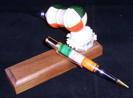

When I ordered some green & orange died blanks and some holy from Lyle to make an Irish Flag pen or two, he was kind enough to throw in an already glued up blank as well! Thanks, Lyle!!! :cool:
Since I only needed to make a couple of the flag pens, I had plenty of blanks left and decided a matching bottle stopper would go well! :biggrin:
Now, this was my first attempt at a bottle stopper...as well as my first use of my new photo booth, and I know the pic could be better...so could anyone tell me, how do I get rid of the gaping hole at the top where the live center was??? :confused:
I also got some of Dale's Irish Tri-Color castings and the one I did turned out GREAT...but I'm waiting on another Wallstreet II kit to show up so I can assemble it! :rolleyes:
Anyway, an answer to my divot problem would be helpful if you have one. Fire away, I'm behind cover again! :wink:

Hey Lee, turn any JD pens yet? Being as Irish as they come, I like your turnings.
For my bottle stoppers. I use a bottle topper lathe chuck. Just drill the 23/64" hole in one end of your blank, thread the blank onto the threaded spur of the chuck. No other support needed. The thread from the spur acts as a tap for the actual stopper. I got mine at Woodcraft, but my local shop doesn't carry it anymore. PSI still carries it though.

I was going to suggest the stopper mandrel too. It eliminates the need for the tail stock, thus eliminating the divot it creates.
There are two sizes (that I've seen) of mandrels. I have one for metal stoppers and one for cork/silicone stoppers.
I've found that even with a stopper mandrel, some of the softer woods and burls can use a little extra support, especially during the roughing stage.
There are several options to get rid of the hole. Most commonly I start with a longer blank and part off the last 1/8" or so (if need be, turn down to a small nub and then cut/sand it off the lathe). Alternatively, make the hole bigger and fill it with a cabochon (you can use all sorts of things like coins, stones, studs, etc.).

Very nice work. You may want to try a small shaped block of wood between the tail stock and the bottle stopper. I do this all the time. During the final stages I take the block off to finish, so there is very little turning time left without the additional support.

I am using Woodcraft's stopper mandrel...bought a bottle stopper set with drill bit, mandrel, and 5 kits...but thought I still needed to butt up against the live center. Tried turning it free after I saw the divot, but couldn't quite get the angle and kept catching the gouge on the wood.
