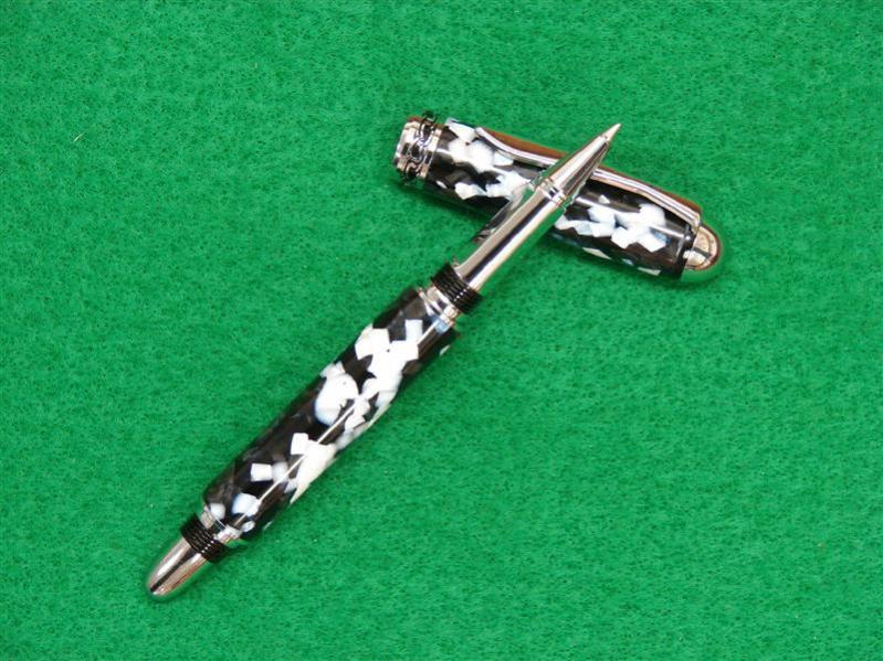

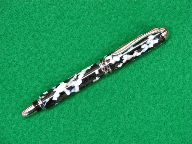

Called "Moo Cow" with a Chrome Sedona Rollerball. Both from WWW.
Finished with 400 grit, super fine steel wool and polished with Hut Ultra Gloss.
Invisavue has a very low melting temperature. Drilled at 500 RPM and turned at 800 RPM.
This material is impossible to turn very without super sharp chisels!!
The beauty of Invisavue Acrylic is that it is so dense that you don't have to paint the inside of the blanks or paint the brass tubes.
As always comments and or suggestions appreciated.
